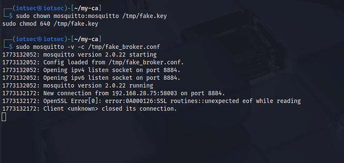

Fix permissions and start:
sudo chown mosquitto:mosquitto /tmp/fake.key
sudo chmod 640 /tmp/fake.key
sudo mosquitto -v -c /tmp/fake_broker.conf
Expected:
mosquitto version 2.0.22 running
Opening ipv4 listen socket on port 8884.
Now in the sketch change one line:
const int mqtt_port = 8884;  // was 8883
Flash and open Serial Monitor.
Expected Serial Monitor output:
WiFi connected
192.168.28.75
Connecting to broker...TCP connected
Broker fingerprint: 24:31:EC:83:30:36:94:0A:3A:C1:CB:6F:7C:7C:01:A6:BC:58:54:2D:5A:31:DA:61:BD:30:69:0A:49:95:DC:8E
Fingerprint MISMATCH disconnecting!
Fake broker terminal:
New connection from 192.168.28.75:58003 on port 8884.
OpenSSL Error[0]: error:0A000126:SSL routines::unexpected eof while reading
Client <unknown> closed its connection.
The fake broker’s cert has a completely different fingerprint 24:31:EC:83... vs our hardcoded 79:47:0B:01.... Mismatch detected. ESP32 disconnected. Attacker got nothing.
