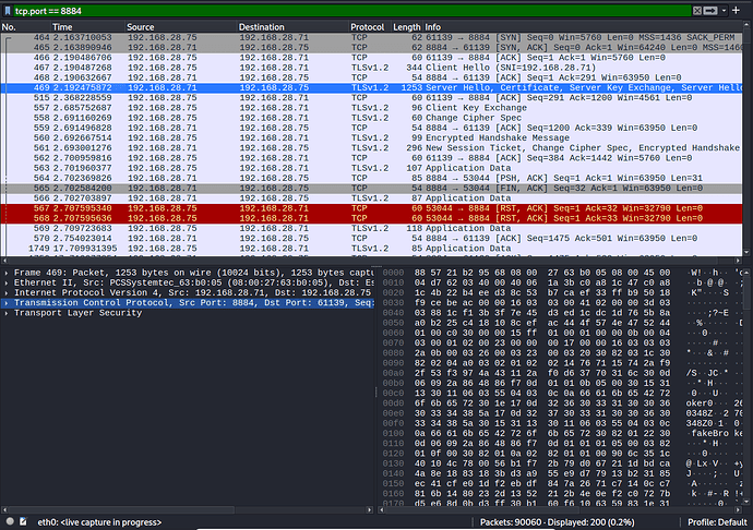

Wireshark - Seeing the Broken Handshake
Now open Wireshark on Kali. Capture on eth0. Filter:
tcp.port == 8884
Reboot the ESP32 to trigger a fresh handshake from the beginning. Here is what the capture looks like:
464   TCP      ESP32 → Broker   SYN
465   TCP      Broker → ESP32   SYN, ACK
466   TCP      ESP32 → Broker   ACK
467   TLSv1.2  ESP32 → Broker   Client Hello
468   TCP      Broker → ESP32   ACK
469   TLSv1.2  Broker → ESP32   Server Hello, Certificate, Server Key Exchange, Server Hello Done
515   TCP      ESP32 → Broker   ACK
557   TLSv1.2  ESP32 → Broker   Client Key Exchange
558   TLSv1.2  ESP32 → Broker   Change Cipher Spec
559   TCP      Broker → ESP32   ACK
560   TLSv1.2  ESP32 → Broker   Encrypted Handshake Message
561   TLSv1.2  Broker → ESP32   New Session Ticket, Change Cipher Spec, Encrypted Handshake Message
563   TLSv1.2  ESP32 → Broker   Application Data  ← MQTT message goes here
Now compare this directly with the Part 6 mTLS capture:
Packet Part 6 mTLS (real broker) Part 7 MITM (fake broker)
Server Hello Server Hello, Certificate, Server Key Exchange, **Certificate Request**, Server Hello Done Server Hello, Certificate, Server Key Exchange, Server Hello Done
After ACK Certificate ESP32 sends esp32.crt :cross_mark: Missing entirely
Next Client Key Exchange Client Key Exchange
Next Certificate Verify ESP32 proves ownership :cross_mark: Missing entirely
Result Both sides verified :white_check_mark: Only broker sends cert, ESP32 checks nothing :cross_mark:
Three things are missing in Part 7:
  1. Certificate Request the fake broker never asked for the ESP32’s cert
  2. Certificate from ESP32 never asked, so never sent
  3. Certificate Verify the challenge-response proof of ownership, completely gone
The fake broker just handed over its self-signed cert, the ESP32 accepted it without checking anything, and the connection went through.
Server Hello Done with no Certificate Request

What Just Happened - Full Picture
We took the most secure setup from Part 6 - mTLS, both sides verified, broker rejecting uncertified clients and broke it completely with one line.
espClient.setInsecure() told the ESP32 to stop being the watchdog. The fake broker presented a certificate that had nothing to do with our Root CA. The ESP32 accepted it without question.
We watched it in Wireshark. The Certificate Request from the broker was gone. The ESP32’s Certificate packet was gone. The Certificate Verify was gone. Three steps that defined mTLS in Part 6 all absent. The handshake completed anyway. The message arrived at the attacker’s broker.
The real broker on port 8883 never saw a single packet from the ESP32 in this entire session.
And the fix: remove setInsecure(), restore the three cert lines from Part 6. The ESP32 becomes the gatekeeper again. The fake cert gets rejected. The attacker is locked out.
