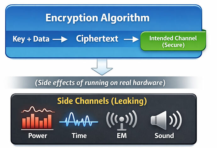

Here’s a picture of what I mean:
| Encryption |
| Algorithm |
| Key + Data --> Ciphertext <-- intended channel (secure)
| (side effects of running on real hardware)
Power Time EM Sound <-- side channels (leaking)
The algorithm was designed to produce ciphertext. Nobody designed it to produce a power trace. But it does as a side effect of running on real, physical silicon.
